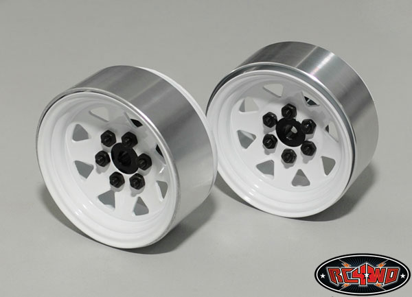

10. Диски 6 Lug Wagon 1.9 Steel Stamped Beadlock Wheels (White)
