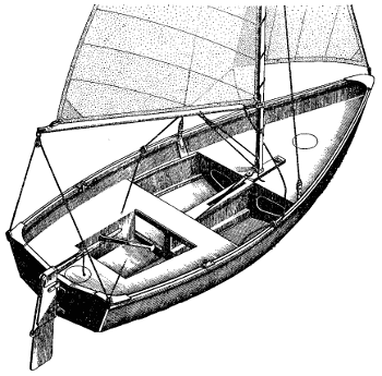

Ulrich. Yes it is. “Трепанг” is sail boart for two or three peoples. I can say what Russian “Трепанг” - is UK “Mirror Dinghy”. I have not big house and big workshop so i made “Трепанг” in my carport. Ulrich, I many read you information before start formation F5-E. Big thanks you.
